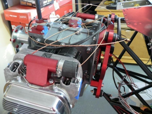

Installed the left and right intake elbows. Checked their fit before applying flange sealer - was glad I did. Found an aluminum shaving next to a stud on the left side, and a blob of hardended sealer around a stud on the right side. Both of these kept the elbows from sitting flush on the head. Would have resulted in an intake leak if I didn't notice. Applied flange sealer to the elbows and torqued into place. Next, fitted the rubber hose connectors on each of the elbows. These were a super-bear trying to fit over the elbows. This is tough hose, and does not stretch much. Used silicone spray and some odd body language to get them on.

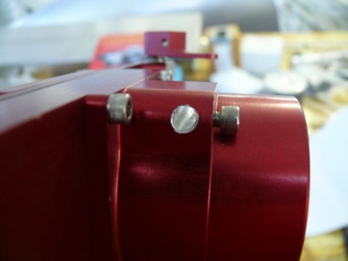

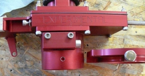

Next was the intake manifold, and with that the carb. Dug out the carb to check the direction it's supposed to be mounted on the manifold. Then noticed that they suggested installing the air cleaner before attaching to the manifold. Glad I researched this. You must position the cleaner base, use a drill bit thru one of the mounting holes to "mark" the location, then drill thru the carb and tap the hole for an AN3 bolt that holds the cleaner base to the carb (pic 2 below). Noticed that the hole in the carb thru which the mixture cable goes was much smaller than MY cable. Further reading showed that you can up-drill that hole to support the chosen cable, so that was done (7/32").

Installed intake elbows & connector hose
Air cleaner mounting hole drilled and tapped
Mixture Cable Clamp Updrilled
