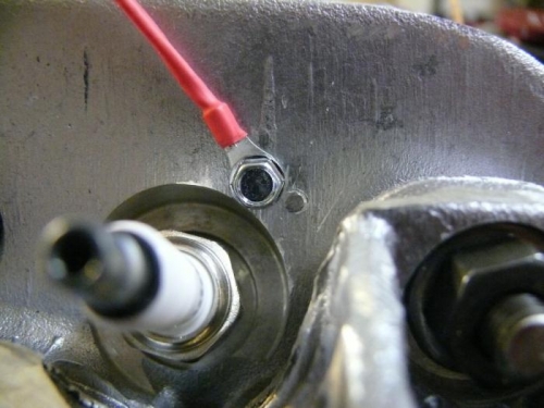

Drilled the 4 holes for the CHT probes. These are Type "K" probes that attach to the head itself, not under the sparkplug. Upon installing two of the #6 self-tapping screws, they snapped off in the head! I drilled two new holes and will have to obtain new self-tapping screws.

Broken Screw at 4 o'clock next to CHT probe
