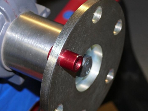

I then rounded up some hardware to install the prop bushings. I didn't have the recommended 5/16" bolt, so I used a 1/4" AN bolt I had available. While the bushing installed OK, I was concerned about ruining the AN hardware with the torque I was applying to it, so I'll wait until I get the correct bolt. The small abrasion area in the pic below was due to the inside of the socket pinching the bushing. Since it's on only about 1/32" of the bushing, there is no loss of structural integrity where I filed it smooth.
Installed Bushing
Installed Bushing
