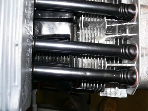

Went to install the "super tin" lower baffles as I had on the right side, but because of the case stud nuts on the left side, I couldn't put the tin in place. I looked and looked, and was just getting ready to start cutting (Sonex provided no information on whether to cut or not...), my #2 son who was helping said "lemme try it." Walla, he snapped it in place with no prob. This side, however, the tin was on the upper fin, right below the head. The right side, I had put it 2 fins down (hard to see on the pic below unless you're familiar with the baffle location. Don't know if I have to change it or not at this point; posed a question on the discussion group.

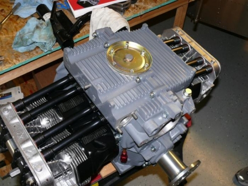

I then installed the oil sump screen, cover, and drain plug.
Next, I installed the blockoff plates for the oil cooler, fuel pump blockoff, and vent.
Studied the oil pump; will have to tap one of the oil cooler holes.
Right side super tin / fin question
Oil screen / drain plug installed
Installed Cover Plates
