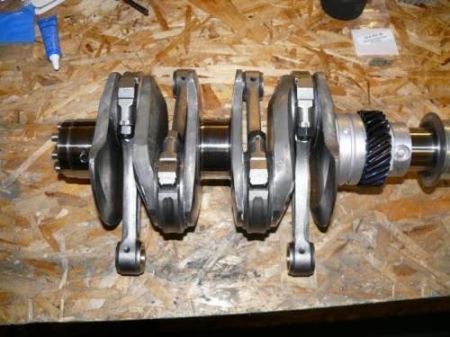

So, today, I installed the connecting rods. Since they were all cleaned and inspected, I just had to press the rod bearings into the connecting rod halves and coat them with white lithium lube. I then lubed the crankshaft journals as well, and hand-tigthed the nuts.
One all the rods were in place, I then removed the nuts on one rod at a time, applied red loctite, and torqued. I first torqued to 10 ft lbs, then 25 ft lbs, as per manual spec.

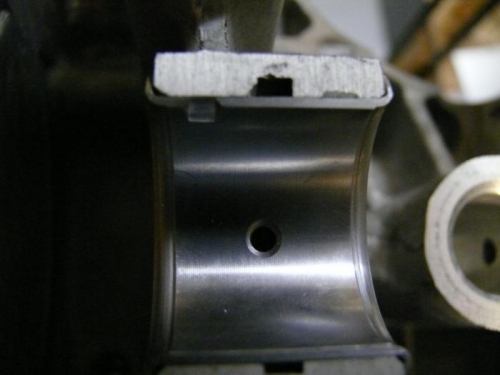

I opened up the cam bearings. The front bearing in the right side of the case has to be modified. The case does not have a notch in it to hold the bearing notch, so you must file the backside of the bearing notch flush so it will fit in the case (see pic 2 below).
Rods Installed
Rods Installed
Special Cam Bearing
Special Cam Bearing
