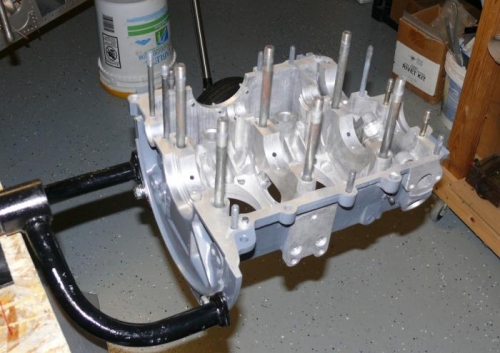

Mounted engine case on stand bolted to workbench. (done last night)

Engine Mounted on Stand
