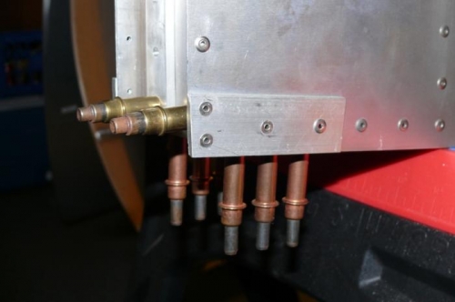

Drilled-out 4 domed rivets on the rudder stop plates, countersunk the holes, and replaced with countersunk rivets. 3 on right side, 1 on left.

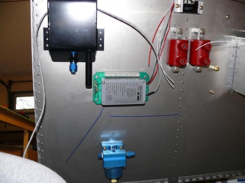

Researched Enigma RDAC location on other builder websites. Marked, measured, drilled, deburred, and attached RDAC to the firewall. Aside from some adel clamps, this finalizes all of the firewall-mounted accessories.
Replaced Rivets w/C-Sunk Rivets
RDAC Mounted
RDAC Mounted
