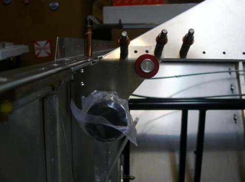

Next, I up-drilled the existing hole in the left panel attach bracket to 1/2" and installed the throttle cable. Eye-balling the mixture cable position, it looked like it would fit on the upper portion of the same bracket. I placed a dot, and removed the bracket to measure and drill. It looked a bit too close at 2.25" center distance between the controls; I mention this only because some builders have mentioned that their placements (regardless of location) were sometimes a bit too close for comfort. So, I took a scrape piece of metal and drilled two holes 2.25" apart, and installed the cables in that. I felt that there would not be interference, especially since the throttle sticks out much farther than the mixture, even when both are fully pushed in.
Removed the cables, drilled a 7/16" hole in the aforementioned bracket for the mixture cable, and installed the cables. One thing I did not adequately plan for was the mounting nut on the back of the mixture cable. This is pressed right up against the underside of the lower panel cross-brace, such that it will be difficult to remove if needed. I'm going to see if smaller hardware is available.
