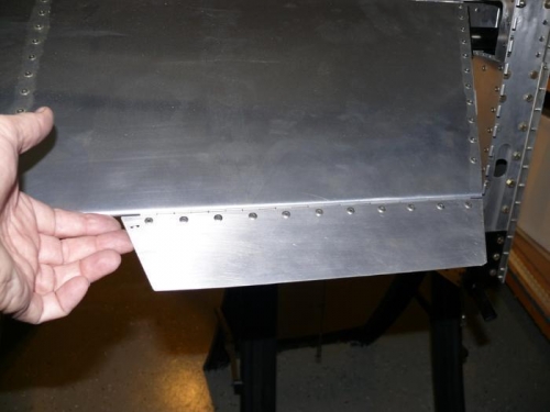

Determined where I was going to drill holes for the rudder hinge pin cotter pins. Prior to drilling I remembered that I had to install the elevator push rod before installing the rudder. Installed the pushrod and bolted it to the elevator control horn, and that's where the fun started. The elevator would not make the full swing up or down.
Noticed that in pic 1 below, the rounded arch thru which the elevator rod passes was hitting the rod when it was moved both fore and aft. Since I had both the horiz and vert tails installed, this was a real pain to re-shape. Used a manual half-round file, a carbide cutter in my Dremel, a sanding drum in the dremel, and a cutoff disk to do all the shaping. This was tedious and time consuming, with lots of stops to check the fit, cut some more, etc.
Also noticed the aft angle at the very rear of the fuselage was also hitting the elevator rod. I previously had to notch that to accomodate the elevator control horn, but neglected to notch it wide enough to accomodate the added width with the push rod installed. As I stated earlier, if the vertical stab was off the fuselage, it would have been no big deal to reshape this. Tight quarters and odd angles just added to the tedium

Elevator Pushrod / Reworked Angle
