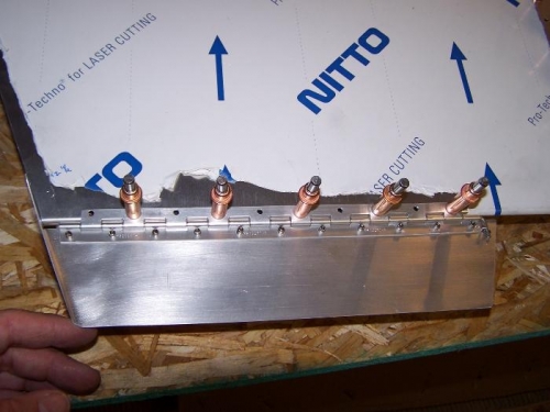

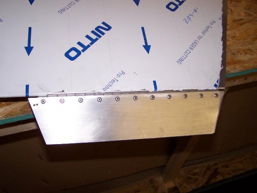

On my previous entry, I thought I was ready to rivet; then I remembered the trim tab was to be mounted on the one elevator that I had ready to go.
Drilled the skin using the trim tab hinge as the template; then up-drilled to #30. Completely disassembled the elevator to deburr inside the skin; cleco'd all back together. NOW I'm ready to rivet.
Top Side, Left Elevator, showing Trim Tab Mounting
Bottom side, Left Elevator, showing Trim Tab Cleco'd in place
