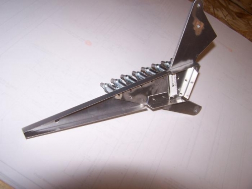

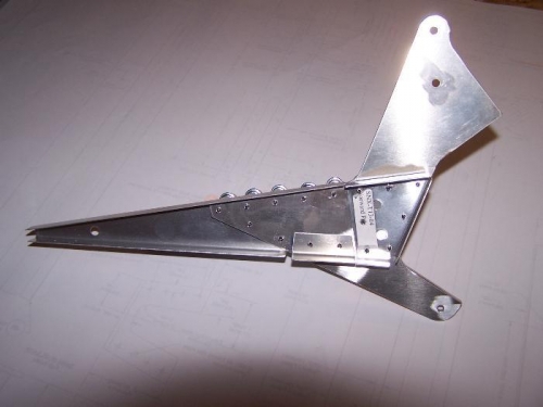

Brief Description:  Rudder Control Horn Assembly
Added oil to my new Harbor Freight pneumatic riveter. Also obtained some cleco-clamps to help hold the small pieces while drilling. Used them on the new SNX-T13-06 I had to remake, but messed *this* one up as well! Made yet another SNX-T13-06 and this time, put in a cleco after drilling each hole. Then drilled the next hole, cleco'd it, etc. Mounted forward rib, clamped it well, and drilled and cleco'd it all together. Just have to debur and rivet.
