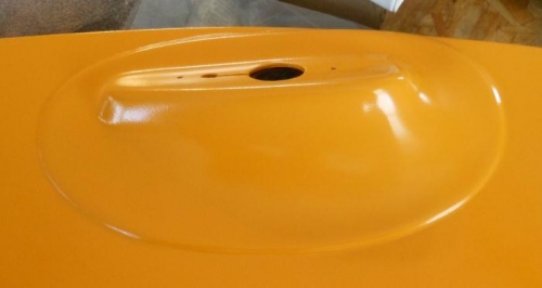

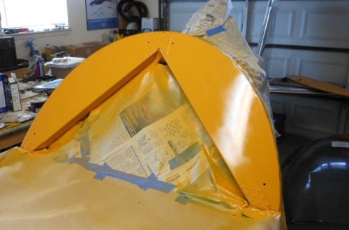

Also, because of masking paper (see pic 1), I cannot do anything in the cockpit until the turtledeck formers are done. There really isn't much of anything else left to do....

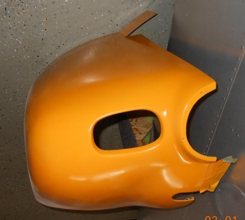

We were up in KS for 5-6 days, so the paint should have cured sufficiently to keep it from crazing. Seems to have worked. Pic 2 shows the nefarious right wingtip; I shot it with some more color coat, then, within the hour limit spec'd on the can, I shot it with clearcoat. Very nice. Both wingtips essentially done now, except for the compounding. I'll wet-sand each with 400 grit, then let them breath for a few days before compounding.
Both wheel pants also ready for compound. Touched up a spot or two on the right pant today as well; will wet-sand in a day or two, then compound those as well.
Re-color-coated the turtledeck formers after the dreaded crazing. Also shot a coat of clearcoat; will wait a few days, sand (unfortunately, can't wet-sand this location....), then compound.
