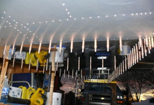

Lastly, I cleco'd the aft skin in place. Don't know when I'll rivet, just to make sure I don't need access. First installed the two MS screws at the aft end of the skin; was easy to install them with the front side of the skin hanging down, allowing a wrench to be applied easily. Finished cleco'ing almost all the way to the front.
The aft skin fits UNDER the foreward skin which was already riveted in place except for the aft edge. I was able to bow the last few feet of the lower skin to get it inserted between the foreward skin and the first lower crosstie by the aft spar. Inserted cleco's and called it a day.
Looking aft
Looking aft
Looking Forward
