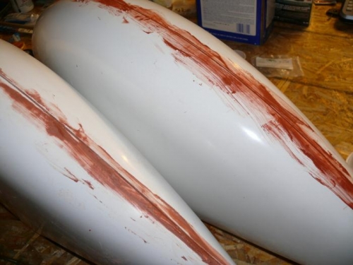

Started the day by putting another coat of paint on the sanded wheel tips. Bought a tack cloth to clean things up as well. This time, however, there was some peel-up of underlying paint; will let it dry for a few days before doing anything else.
Next, I used some filler putty to go over the seams of the wheel pants. This stuff sands off pretty easy, but has to dry a bit first.

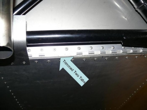

The lower cowl attach points using piano hinge were done as per plans. Since I have an AeroVee engine, I had to install an exhaust shield right where a gap existed to allow insertion of the retention pins. I trimmed-off two eyes of the piano hinge and made up new hinge pins for the current configuration.

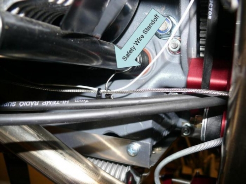

Lastly, on my last tech inspection, the counselor noted that I had used nylon ty-wraps around the pushrod tubes where I was supporting the oil temp and EGT wires. He said it was OK, but that they might melt. Today I removed all the nylon that was touching the engine and used safety-wire to create "standoffs". I then used ty-wraps to secure the wires to the safety wire so that the risk of cutting thru the wires was reduced.
Puttied Seams
Puttied Seams
Trimmed Hinge for Access
Changed nylon for safety wire
