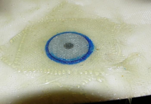

Next, several builders reported that their wheelpants cracked where the mounting screw goes into the axle. Installed two layers of glass matte over washers to help provide reinforcement (both pants).

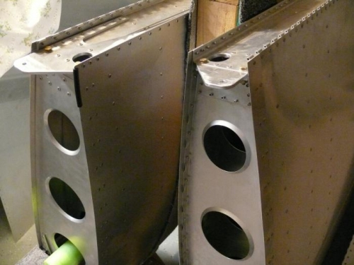

Lastly, I riveted the wing doublers on both wings. Only had to drill-out and replace one rivet. Had some rivet issues with the new rivets - the mandrell pulled right thru in a few cases and became jammed in the nose of the riveter. Had to remove the nose and literally drive-out the stuck mandrel. Otherwise OK.
Glassed-In Reinforcement Washer
Doublers Installed Both Wings
