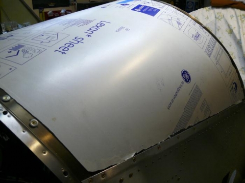

Next, I installed the fasteners for the windshield. Ran an 8-32 tap thru the windshield aft bow holes since they had some paint in them from the other night. My son helped to get the forward side nuts onto the machine screws. I previously installed nutplates in the forward firewall bow; made it super easy to get those installed.

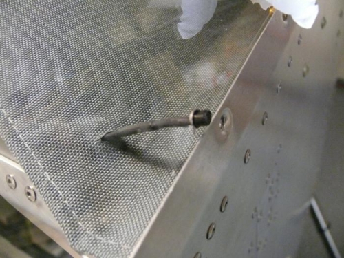

Drilled a hole in the side of the windshield to allow the OAT sensor to be in the slipstream. Will seal with a dab of silicone caulk after I finish installing the windshield side hardware (ran short by 4 nuts).

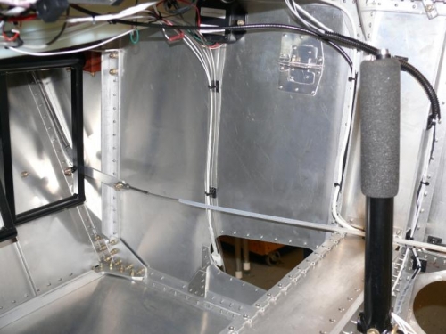

Lastly, tied-down the pitot/static lines on the right side of the fuselage, and the lighting wires on the left and right sides of the fuselage.
Windshield installed
Secured pitot/static & lighting wires
OAT sensor thru hole in windshield
