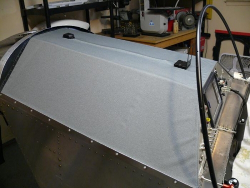

Last night I had only glued-down the center surface of the glareshield cover. As it would still move around a bit, I gave it overnight to dry. Today it was much better secured.

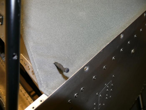

Folded-up the left side piece; sprayed the fabric and the glareshield with 3M trim adhesive and smoothed into place. Repeated with the right side; first, however, I cut a slit for the OAT sensor that will be mounted in the side of the windscreen.
Worked at it quite a bit to get it smoothed out as best as could be done. Trimmed the excess material from the front and sides.
Next, I got out the windshield material that had previously been test-fitted. I experimented with the microstop countersinking tool on a scrap piece of Lexan; proceeded to countersink all holes in the windscreen. Installed into position in the fuselage, but have not installed any fasteners yet.
Overall view of installed glareshield cover

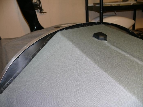

Forward edge
Forward edge
OAT Sensor; will protrude thru side of windscreen
