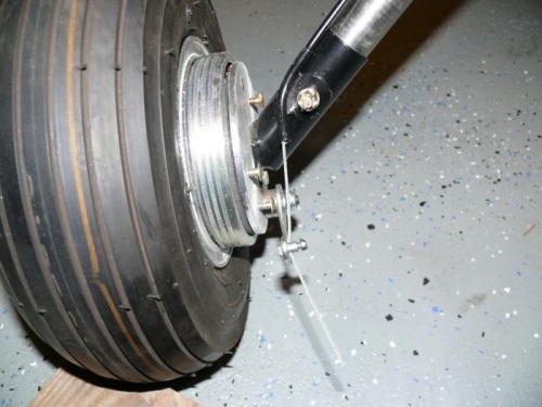

Tonight, I installed the brake cable housings. I had to cut each side to length (different each side), determine the best routing, and install the cable in the housing. Then I secured the housing to the motor mount using zip ties cushioned with self vulcanizing tape to protect the mount. Installed the cable at the wheels, adjusted, and tested.

Brake Cable Secured at Wheel
