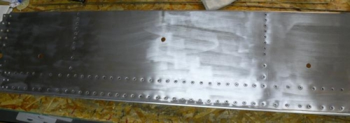

Received new rivets (CCC-44) yesterday to allow completion of the aft spar tunnel.
Cleco'd and riveted over one hundred rivets to secure the support angle and two vertical angles to the skin of the aft tunnel. Messed up on some of the upper rivets on the vertical angles, so had to drill them out and replace; I had not supported the top edge of the angles when riveting, so they were an overall loose fit. Now fixed.
Since the spar tunnel is a tight fit, I filed the inner surface to ensure that no rivet edges would catch on the spar as it was inserted. Buffed it all with scotchrite. Installed into fuselage with cleco's. Had to check the fit of several pieces to ensure that the miniscule shifts due to cleco's in the rivet holes didn't prevent alignment of the spar pins. Because this is a tight-fit area, had to make some slight adjustments.

Aft side of aft spar tunnel
Inner Edge; filed & Scotch-Brited
Cleco'd into position in fuselage
