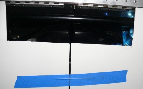

Anyway, on Monday I spoke with Jeremy at Sonex to see if I could get any hints on where to trim in order to reduce the gap at the back of the cowl. He said to concentrate on the corners. I really didn't want to glass-in a patch piece more for pride of workmanship.
So tonight, I re-trimmed the lower left corner, and that brought the 5/16" gap quite a bit closer together. Then I noticed that the bottom bowl part of the cowl was rubbing, so I made about 8 on-and-off cycles trimming various areas on the lower bowl edge, all the way up to the prop hub.
I am very pleased with the results. The picture does not show the real gap (about 3/32") because I had no extra hands to push the cowl togehter that last bit. Again, this is all in the last 10-12" on the aft lower edge. I still see some areas a bit forward from here that can be filed down some more, but the june bugs were really really trying to get into my ears so I called it a night.
