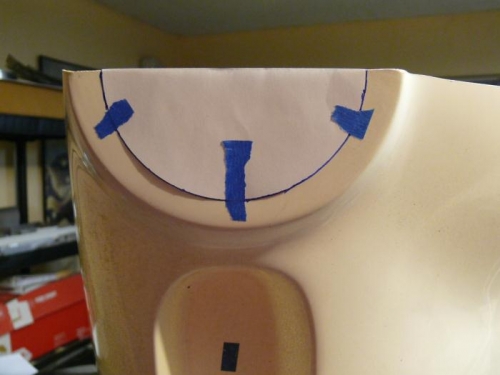

Drew a trim pattern in PowerPoint with a 5" circle for the prop hub, and bifurcated it with a line nothing the center of the circle.
Creased the template along the line, and set it in place on the right cowl half. Taped to secure it. Marked the outline with a Sharpie.

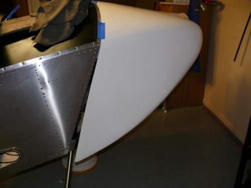

Removed the template, took it outside, and used a saber saw to cut the glass. Initially smoothed the cut with sandpaper in my hand.
Took it in and set it in place around the prop hub. Very close. Looks like the initial fitting will go relatively easy.

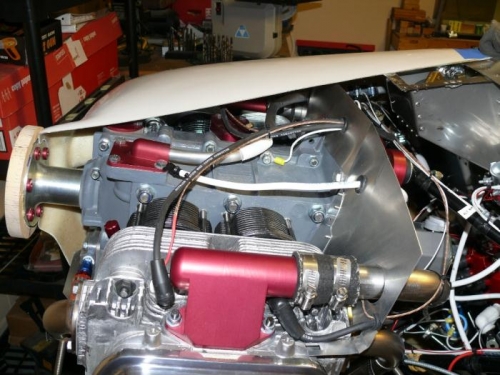

Ooops. Then I noticed that I forgot (really hadn't planned for tonight) to cut the cowling for where the gear legs will protrude, along with the gascolator, fuel vent, and crankcase vent lines.

Paper Template Applied & Marked
Fits All Around
Fits All Around
Ooops - have to trim for the gear leg & crankcase vent
