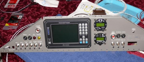

This past week was extremely unusual weather for Texas. At this time this is written, we've been over 90 hours below freezing - with lows in the 7 degree range. The garage has been unusable since I cannot get it to heat up above about 45 degrees.

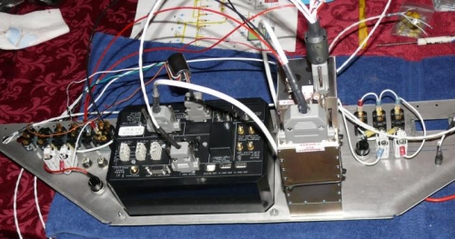

Started wiring the panel today. Mounted the radio & transponder. Wired the switches to the breakers, and am now adding the pre-fab'd wiring harnesses. Have to solder the headphone/mic jacks to the harness, then mount them to the panel.
Have not yet bundled anything - waitng to finish the wiring.Not too bad; getting tight in some places.
