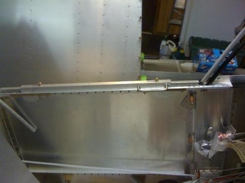

Finished assembling the handle latch assembly. Had to trim some of the fillet out of the angle of the handle in order to allow the nylon washers to sit flat on the surface. Required trimming of the angle plus taking off a bit of the edge of the nylon washers.

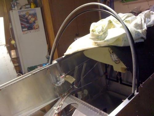

Cleaned the ends of the square tube and the bow material to allow insertion of the angled ends that join the bow to the canopy sides. Put into place for a photo shoot. Will have to trim both ends to get a good fit.
How it's supposed to look.
Bow needs a little trimming....
