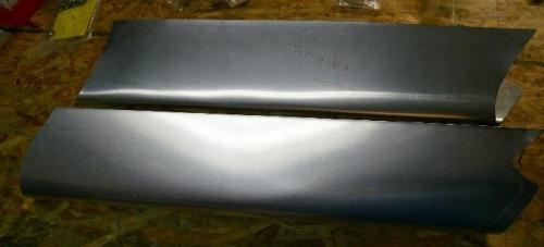

Made up a jig for bending the left and right main landing gear fairings (shown in pic 2 below). Worked OK to start the bend and finish the bend, but I ended up just folding over the skins by hand. Not bad; The ends line up, so hinge attachment and pin installation should be easy.
Unfortunately, both fairings are about 1"" too long - they won't fit between the brake assy & the bottom of the fuselage. Before I start trimming, I'm going to ask Sonex just to make sure something else isn't messed up.
Bent Fairings
Bent Fairings
