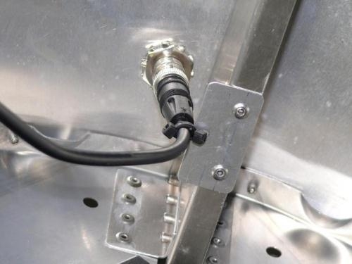

When I installed my ELT, I wanted it as far away from the comm antenna, yet I also wanted it somewhat shielded by the vertical stabilizer in case I ever end up inverted. That, plus the ELT supplier says to use only the provided cable - do not make up your own. The result is that the cable was just a bit short where I could not fasten it to the turtledeck. I fabricated a gusset and riveted it in place. To this I attached a cable tie, then used a second tie around the cable to grab the tie installed thru a hole in the gusset. The antenna does not move now when the cable is moved.

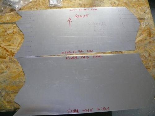

Lastly, I cut out .025 stock for the main landing gear fairings. These require some specific edge measurements to fit correctly when bent around the landing gear. Each one is opposite the other, so I had to make sure I knew which was which!

Secured ELT Ant Lead
Main Landing Gear Fairings Cut
