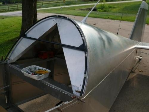

The left side rail had not been drilled up until now; used the outer side trim to locate the pilot holes. Clamped the trim to the side rail, and drilled using #40 for the pilot holes. Next, on all 4 corners the builder locates the bottom holes in the canopy bows; one example is visible (the left front) in picture 2 below. Updrilled the holes.
Next I located and drilled the holes in the fore and aft bows. Once drilled, these will be tapped for a #6 screw to hold the canopy transpaency in place. Since I had already painted the aft bow assy, I used pieces of masking tape to locate the approximate location of each hole, then did a final meausre marked with a center punch. The forward bow holes are just located across from the windshield screws to make it look consistent.
Once the holes were drilled, I removed the frame and disassembled. I deburred the parts, then riveted together. Unfortonately, I forgot that one rivet was supposed to have a tab to hold the locking slide spring, so I'll have to drill it out and re-rivet.

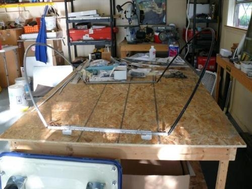

Frame on bench for riveting

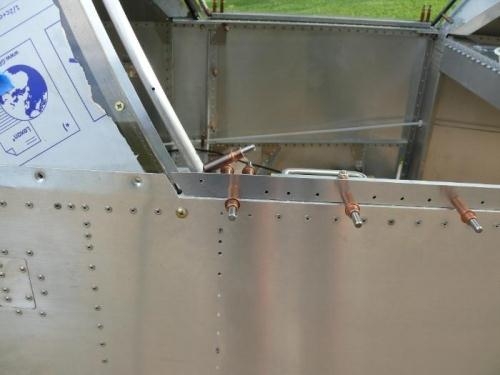

Left side outer trim piece drilled
