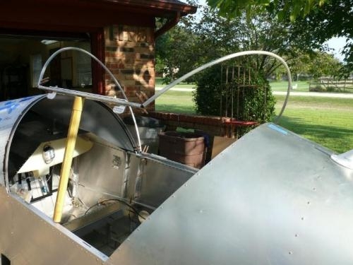

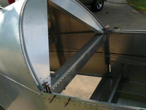

Lastly, spent some time doing final fit/trimming of the aft canopy bow. Jigged everything up for the correct spacing in relation to the turtledeck and pilot-drilled the rivet holes in the corner angles. Up-drilled all rivet holes in the fore and aft bows, and cleco'd. Tested open-ability of the frame, and all checks out well. Still have to make one final adjustment in the aft bow curvature, install the cross piece for stability, then rivet it all together.
Aft Canopy Bow Drilled, Updrilled, and Cleco'd
And it even flips open!
