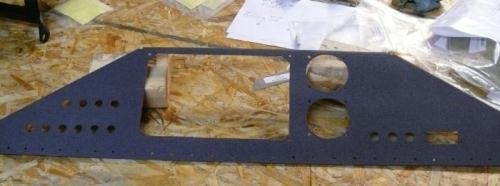

I included a picture of the painted panel below (mentioned it yesterday). I like it; the finish is even, so I'm just letting it dry several days before I start mounting things.

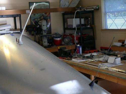

Located and mounted the comm antenna. It's supposed to be at least 3' from any other antenna, which is where it is located from the ELT antenna. I didn't want it too far forward just to keep RF from the ol' brain bucket. I *still* have not been able to find correct mounting hardware at Lowes / Home Depot, so I guess I'm going to have to find some AN hardware. It's held with cleco's for now.

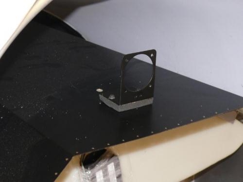

Lastly, I mounted the compass bracket.I tested the GPS antenna against it, since the antenna has a built-in magnet. As long as the magnet is about 8" away from the compass, there is no problem. I will have mine closer to 18" forward on the glareshield so I don't expect any issues.
Finished Panel
Finished Panel
Comm & ELT Antennae
Comm & ELT Antennae
Compass Mount
Compass Mount
