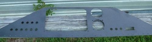

I'm at another one of those "sequencing" points in my construction. I didn't want to wire the panel until I had my radios. Couldn't wire until I mounted the components. Couldn't mount without painting first. After painting the panel yesterday, *today* read that the paint isn't really fully dry for 5-to-7 days. It was obvious because the paint was dry to the touch, but it would "ding" easily.
I shot another coat of paint and set it aside for a week.

Painted panel
Painted panel
