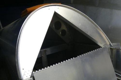

Continued trial fitting of aft canopy bow. Repeatedly bent in / bent out bow to match the curvature of the aft fuselage turtledeck.
At this point, it's pretty close, but not perfect. I think I'm going to get out the Sonplex canopy and do a trial fit of that to see how that fits against the fuselage to finalize the last bends.
Initial Fitted Aft Bow
