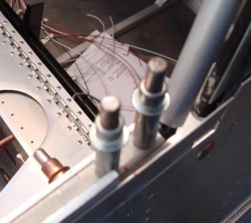

Spaced the rail using 1/8"" shim stock to simulate the canopy being in place to ensure that the bow geometry didn't change as a result of final placement of the hinge assembly.
Ensured spacing of the forward bow to the aft windshield bow. Made small adjustments with the canopy bow angles. Marked rivet offsets since there's not enough room inside the angle (4130 tubing) to have rivets directly opposite one another.
Drilled pilot holes on each side.

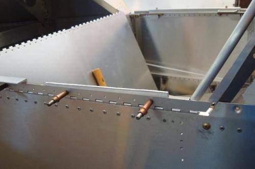

Lower hinge riveted to Fuselage; canopy hinge pinned in place and spaced for alignment
Rivet holes in canopy bow angles
