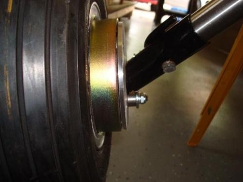

Continuing from Wednesday, I bent the left brake cable guide to fit the axle and to provide the correct angle for the cable to connect with the actuation lever.
Next, I drilled the backing plates where they mount to the axles and attached with AN3-4A HW, which is one size smaller than the plans state. Other builders clued me in on this area; the -5A HW is a bit too long, and gets caught up in the brake return spring.

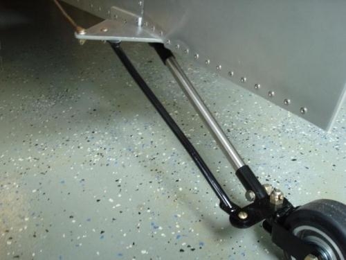

I then rigged the tailwheel; was waiting on some AN hardware to arrive from Wicks. In rigging the link I had to bend a dogleg in it because the link was digging into the rudder control horn. That was followed by lots of trial and error with washers combinations (thick and thin) to get a non-sloppy fit of the linkage. Can't be tight (binding) either.
Installed the gear legs to the motor mount; installed AN4 HW and torqued to spec. Assembled brake / axle assemblies to gear legs. Adjusted backing plates as per recommended procedure (banging with a mallet!). Then, marked the location for the cotter pin holding the axle nut in place. The builder must locate and drill this hole.
Removed all parts. Drilled the axles; cleaned up, deburred. Reassembled the assemblies to the gear legs; packed the wheel bearings. Installed cotter pins.

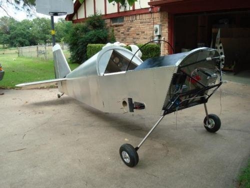

Next, the moment that's almost as good as a first flight; took it off the sawhorses and on her own 3 legs! Naturally, I had to wheel 'er out into the sunlight and pose her for numerous pictures.
Backing plate pretty even all around
Installed tailwheel steering link
...and into the daylight for the first time!
