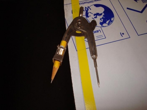

Using a compass, I set it for 1", which is the set-back distance for the windscreen from the fwd edge of the firewall upper bow. The pencil marked the protective film just fine, but I added a line of tape to provide better contrast.

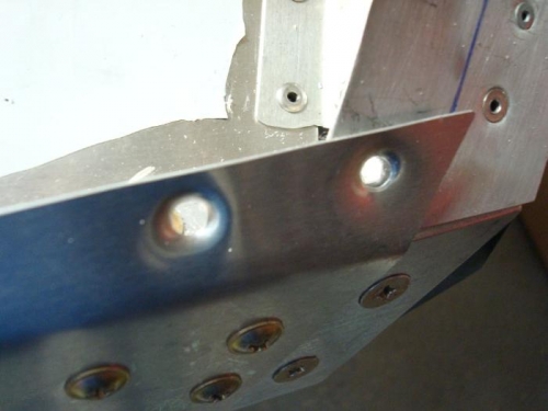

Removed the lexan and dimpled the fuselage sides with the rivet squeezer. It was a tight fit at the fwd-most hole on each fuselage side, so I dimpled-thru the fuselage side and the firewall bow, then went back and squeezed the firewall bow back to a flat condition with my flanging pliers.
Used a compass to set 1
Used a compass to set 1" distance from edge of firewall bow

Closeup of fwd-most hole
