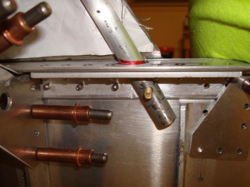

Brief Description:  Final sizing of windshield bow / drilling bow
Well, it's been awhile. Went to Kansas for the Memorial Day holiday, then I had to catch up on some yardwork from my absence, and then EAA held two webinars that I really wanted to see.
I had been playing around trying to determine the correct height for the windshield bow by trial-fitting the windshield, checking angles, etc. Trimmed more than I thought I would have to trim in order to get it to sit just right, but as a result it looks quite good. Clamped into position and drilled to 3/16" without pilot drilling since the longerons already had 3/16" holes in them from the factory. Inserted AN525-10R16 hardware just to keep in position. The bugs were getting to me, so I'll clean it up tomorrow.

Untrimmed; bolt in position just to hold
