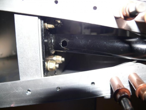

Brief Description:  Re-Mount Tail Wheel Mount
Installing the tailwheel mount on your back, from the bottom side of the fuselage is no fun. At least, it's less fun than doing when the fuselage was inverted a few months ago.
I had removed the tailwheel mount a few months ago to make the fitting of the vertical stab easier. It was not time to re-install it. Not much room to get fingers in there, let alone wrenches. Used needle-nose pliers to get the washers onto the bolts, then had to tape the nuts into a box wrench to get them started. Not bad, just time consuming with wierd contortions to get my arm positioned just right.
Tailwheel Mount Installed (ran out of AN3-7A on bottom)
Inner flange of tailwheel mount
