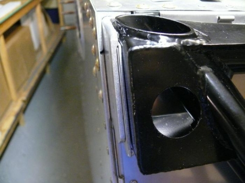

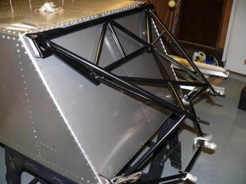

Brief Description:  Motor Mount Shims

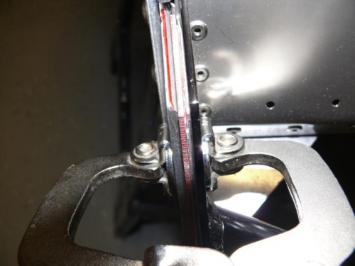

Measured and cut shims to go between the mount angles and the mount itself. The plans say that the design allows for a nominal .060 gap; I was able to use 3 shims on the upper angles and two on the lower. Looks like I will have to remove just a smidgeon more material from the lower mount angles to reduce contact area in the corners. Otherwise the fit is good.
Clamped in Position
Clamped in Position
Close-up of upper shims - .063, .032, and .025
Close-up of lower shims - .063 and .032 used
