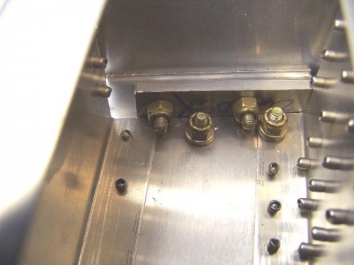

Once that was done, did the official wrap-up of the aft fuse / turtledeck. Flipped the assy upside down on the sawhorses. Fitted and torqued the AN525 hardware that goes thru the side skin, longeron, and turtledeck skin (see photo 1). This has to be done before the crosstie box is riveted.

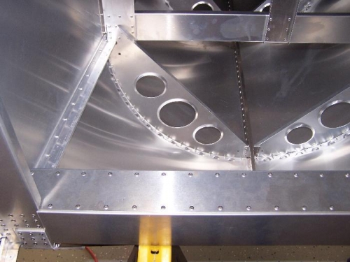

Then, riveted the crosstie box.

Installation of AN525 HW thru Side Skin / T-Deck
Riveted CrossTie Box (upside down)
