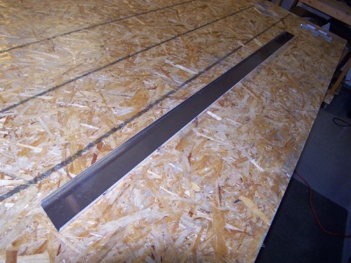

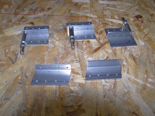

Started TurtleDeck construction tonight. Fabricated detail parts on SNX-F20, which consists of 6 clips that will attach the t-deck formers to the skin splice channel as well as fore and aft clips for each end of the channel.
Cut the splice channel to length, and angled each end as per plans.
One note: The plans don't mention this, but the clips that attach the formers to the channel should be match-drilled, since they'll fit on opposite sides of the channel.
3 Clip Pairs, Fore & Aft Clips
TurtleDeck Skin Splice Channel
