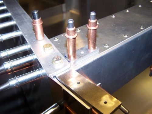

Up drilled upper splice-plates-to-crosstie box to 1/8" as noted in picture 1 below. Also Up-drilled splice plates to longerons; took to 3/16" for AN3 hardware, also shown installed in picture 1.

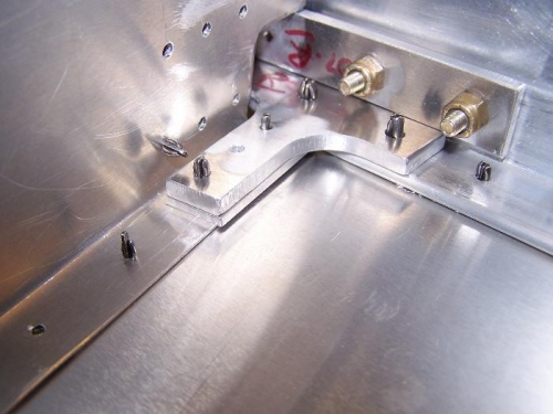

Drilled the lower splice-plates-to-lower crosstie and updrilled. Included spacer plate as showin in picture 2 below.

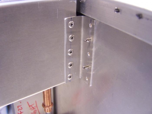

Locate and drill clips to crosstie tie box (pic 3) & up drilled.

Removed all front crosstie vertical and horizontal channels & splice plates. Deburr all. I decided to rivet the clips to the crosstie box because it looked like it would be a tight fit later on once positioned back in the fuselage.
Repositioned crosstie box. Installed four AN3-7A bolts thru upper splice plates (crosstie box bottom must remain off).
Upper Splice Plates Drilled & Bolted
Lower Splice Plates Drilled thru Spacers
Clips on back of Crosstie Box
