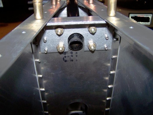

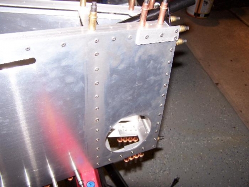

Then, riveted external sides. This includes the right side of the vertical tail spar (left side hosts the rudder hinge, so this must wait until tail is mounted). Also includes riveting the bulkhead to the skins (see pic 1 below).
Bolted tailwheel mount to bulkhead attach angle (see pic 2).

Right Side (Upside Down) All Externally Riveted
Inside (Upside Down) Showing Bolted Bulkhead
