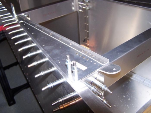

With the skin, upper edges of the longerons, and crossties pilot drilled, I was completely out of 3/32 cleco's. Did a reclamation effort by up-drilling the lower crossties and crosstie box to 1/8".
Pilot drilled the upper crossties. Each one has 12 holes - only 5 will get riveted at this point, with the other 7 related to the turtledeck formers.
After completing the upper crossties, I realized that I should have used the seatbelt attachment brackets as the pilot hole location for the number 3 crosstie. Ooops. Was I relieved to see that both holes that correspond to the crosstie were drilled EXACTLY spot on. Whew!

Right Side Up. Lower's Updrilled; pilot drill uppers
Placement of Seat Belt Attachment
