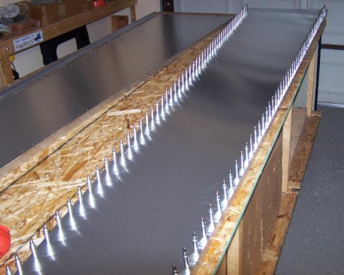

Brief Description:  Aft Fuse Right Side
Trimmed ends of right side upper and lower longerons. Positioned on the skin surface, set back from the bent edge (forward edge) of the skin by 1/32".
Drilled and cleco'd into position. Upper edge stays just cleco'd for now - have to fit the turtledeck before final up-drilling and riveting.
Positioned the lower longeron into position. On this one, the longeron fits .025" from the lower edge of the skin to allow the bottom skin to fit flush against the side skins.
Drilled and cleco'd into position. Still have to fit the rudder stop, then up-drill and rivet the lower longeron.
