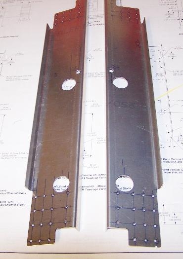

Brief Description:  Completed SNX-F27 Detail Parts
Cut out relief areas on SNX-F27-01R that were marked up last night. Drilled two 1" holes and one 5/16 hole (trim cable). Deburred all bandsaw-cut areas.
Marked up SNX-F27-01L, the mirror image of the right hand piece. Cut all relief areas, drilled holes, and deburred the bandsaw-cut areas.
This completes SNX-F27.
