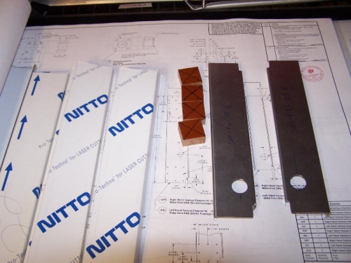

Brief Description:  Aft Fuse Detail Parts Prep
Spent most of the afternoon on this stuff, but it sure doesn't seem like much got done. Was interspersed with several interruptions. Some good, like the 35 minute phone call I had with a Sonex builder from South Dakota, some were needed, (like vacuuming the chop saw, which hadn't been done in a looooooooonnnng time), along with phone company repair guys, and general other stuff.
Anyway. Cut channel stock for SNX-F27-01 / -02 / -03 / -04 / -05 vertical channel pieces. Trimmed and drilled for fairlead SNX-F27-05L / -05R, the aft-most channel pieces to the completed status.
Cut angle stock ( 1 x 1 x 0.125) to length for parts SNX-F26-02L / -02R, and SNX-F26-03L / -03R, the upper and lower longerons for the aft fuselage.
Cut SNX-F26-08 to length and made a 3/32" angle on one end of each piece (2) to form the rudder stop for each side.
Lastly, cut a 2 x 3/4 x 7 block of phenolic into 4 squares, each 1 9/16" x 0.75. Marked location of center 3/4" hole and the 4 corner holes (1/2 the hole is 1/8" wide, remaining half is 1/4" to accomodate CCP-46 rivets).
Channel stock, phenolic fairlead blocks, and aft vert channels.
