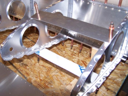

Flipped wing back over so it is right-side up.
Dimpled upper side of fwd rib flanges.
Fabricated spacers to hold ribs at 10" center-to-center spacing during installation of landing light kit from Duckworks Aviation.

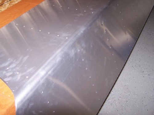

Deburred in/out sides of left leading edge skin. Deburred all edges, rounded corners.
Dimpled both upper and lower outer surface rivet holes in preparation for riveting.
Spacers to Maintain 10" Rib Separation for Light
Dimpled LE Skin
