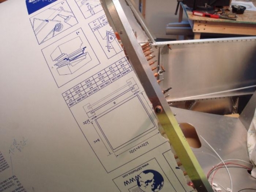

Started off by re-installing the lexan into position. Cleco'd the sides into position using existing holes. Marked the location of the holes that will be drilled to secure the lexan to the bow. Clamped the rear bow into the 60 deg position. Measured 5/16" forward of the aft edge of the lexan. Drilled 3/32" pilot holes and used long-reach cleco's to hold it all in position. Updrilled to 1/8"; again, used long-reach cleco's to hold into position.

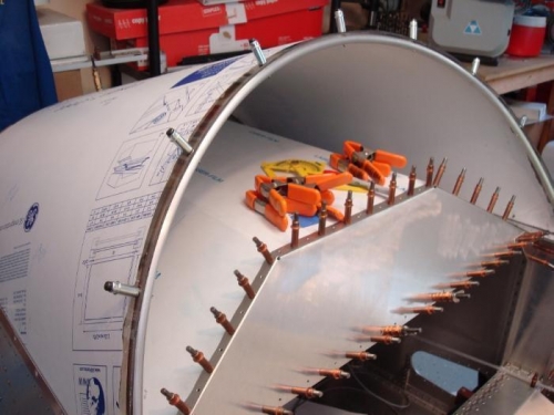

Drilled the fwd edge of the lexan where it will abut the cowling. Other builders have added additional screws on this edge to reduce waviness of the lexan. Didn't think I would have to, but today it just seemed loose. Added 4 additional holes thru the lexan and upper firewall bow.

Initial Pilot Holes
Initial Pilot Holes
Drilled holes in fwd edge; added 4 additional holes
