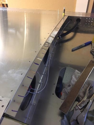

Date:  5-11-2018
Number of Hours:  0.80
Manual Reference:  C75-WA-3
Brief Description:  Rivet trailing edges & fuel tank top skin; prep ro
Riveted all of the upper trailing edge rivets and the upper fuel tank skin - except for the root skin edge & root rib. This skin is not riveted until final assembly prior to inspection. Bent the root skin angle to match the slope of the root skin to the root rib; this will be pilot and final drilled, but not riveted. This will take some finessing since the butt joint with the root nose rib skin is challenging.
All top rivets except for root skin done
root skin angle marked & bent
