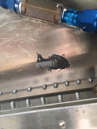

Had back issues the last few weeks; very painful. Finally had some relief today so got some stuff done.

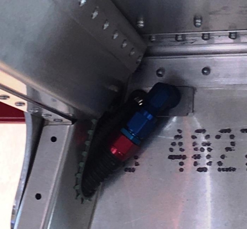

Trimmed top and bottom of internal L angle reinforcing structure just as I did for the left side.
Several attempts were made to route the fuel and electric lines just right to reduce compression and abrasion.
Installed the lower fuel drain on the right side. Tightened. Will need to safety-wire.
Following the fuel lilne routing, iz mixed up some JB Weld and installed the left and right brake line tubes thru the floor.
