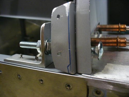

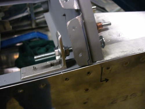

Brief Description:  Made canopy frame stop bolts
This is a sweet mod some builders have made to prevent the canopy from jamming forward against the front skin due to the force of the tip up gas struts when they are installed. Basically a bracket is made with an attached carriage bolt that serves as a stop bumper.
