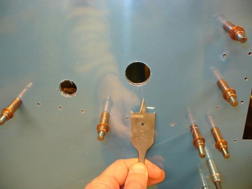

Added the fwd fuse floor stiffeners. Lacking a Shivaesque multiple sets of arms, I had Chad Jensen help me on these - thanks, bud. Then went around and drilled all the rest of the holes in the fuselage that need to be done. Also drilled the vent and fule line holes in the side - for the 1 inch fuel hole, I found a carpentry paddle bit with light pressure worked great (pic 2).

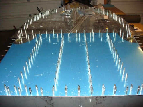

Upside down - looking on forward bottom fuselage with stiffeners clecoed
